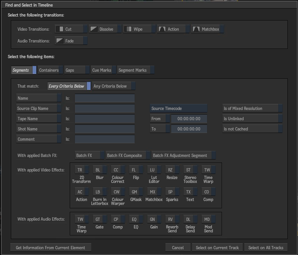

Searching the Timeline
  1. Click the magnifying glass icon at the bottom right side of the timeline.
    The Find and Select in Timeline window opens.
  2. Enable a button or multiple buttons to set your search criteria. For example, you can enable Dissolve in the Video Transitions area to search for all dissolves.
    Tip: You can enable Get Information From Current Element to automatically fill in information from the selected element into the search criteria.
  3. Choose whether to search segments, containers, gaps, markers, or segment markers. You can select more than one or all of these options.
  4. Set the strictness of the search by enabling Every Criteria Below or Any Criteria Below.
  5. Click Select on Current Track or Select on All Tracks to perform the search.
    The Find and Select in Timeline windows closes, and results are highlighted on the timeline.
