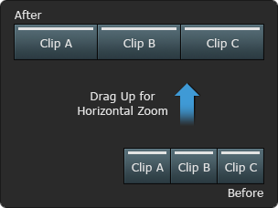

Horizontal scroll bar
To pan, drag left or right. To zoom the timeline, drag up or down.

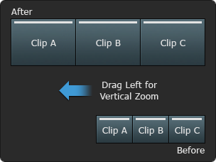

Vertical scroll bar
To pan, drag up or down. To zoom the timeline, drag left or right.

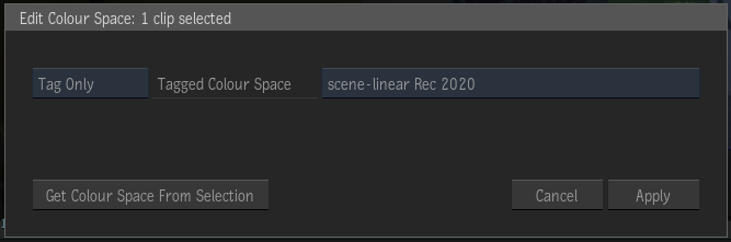

Colour Management
The Edit Colour Space option from a Clip's context menu allows you to modify the colour management options of all the currently selected sources. This tool does not affect Sequences, only sources.
Tool Mode
Select whether to convert your media into a different colour space or only tag them.
Tagged Colour Space
Select the colour space to tag your media with. This does not modify pixel values, but it does affect how viewports display your media.
Input Colour Space
Select the source colour space of your media. From Source uses the currently tagged colour space, which allows you to easily convert a set of clips in various colour spaces to a common working space.
Working Colour Space
Select the destination colour space of your media. Set the Working Space first in order to filter the list of Input Colour Spaces to only show the compatible options. From Project takes the value from the Colour Management Preferences.
Get Colour Space From Selection
Click to initialise with the colour space of your primary selection.
