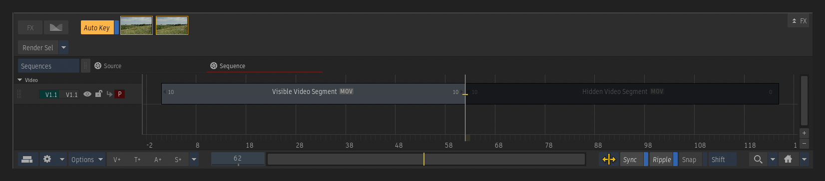

Hiding Timeline Segments
Timeline segments can be hidden using the Hide Segment option from the context menu of the Timeline segment in question. Hidden segments are slightly darker than visible segments.
Once a segment is hidden in the Timeline, it is ignored in the following situations:
  • It does not appear in the Player.
  • Its Timeline FX do not appear in the Timeline FX bar and editing them is not possible.
  • It is ignored in Publish and Export.
Hidden segments remain searchable, via the Timeline Search Tool.
To restore a segment’s visibility status, select Show Segment from its context menu.
The "Show / Hide Segment" keyboard shortcut is assigned to the Ctrl+H keystroke by default in all profiles.
