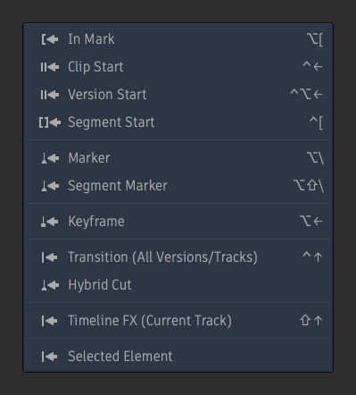

To navigate between In Marks, Out Marks, and Markers use the buttons at the ends of the Player navigation cluster.
By default, the buttons navigate to the In Mark and Out Mark set on your clip. More options can be selected by clicking the button and holding until a drop-down menu appears.
Select the Marker or Segment Marker options to navigate between Markers.
Note: The last selected option are set on the Go to Previous and Go To Next buttons.
