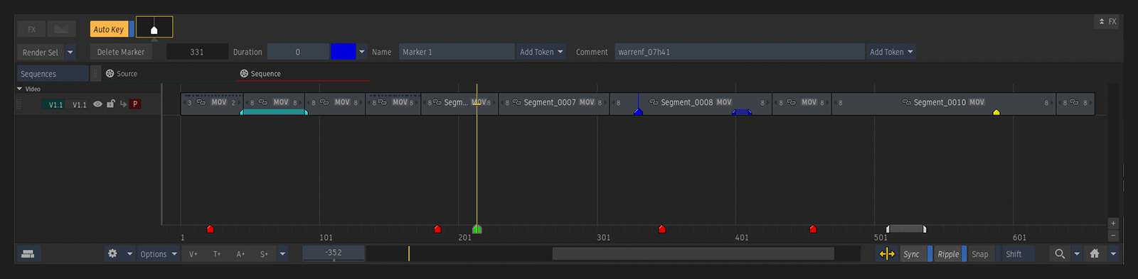

Using the Markers view
The Markers view displays all of the Markers and Segment Markers set on the clip currently displayed in the Player, in a table. It can be accessed from the Player Options drop-down button or by using the Toggle Markers Panel keyboard shortcut (assigned to Ctrl+5 by default in the Flame keyboard shortcuts profile).

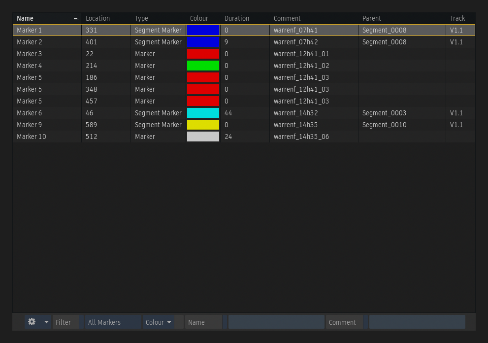

Columns
From the Markers view, you can organize your markers, by naming them, assigning them a colour and a comment. The following information is displayed in the Markers view:
  • Name: Displays the marker's name.
  • Location: Displays the record frame (in frames or timecode) on which the marker is set.
  • Duration: Displays the duration of the marker
  • Type: Displays whether the marker is a marker or a segment marker.
  • Colour: Displays the marker's colour.
  • Comment: Displays the content of the marker's comment.
  • Parent: Displays the name of the segment on which a segment marker is located. This applies only to Segment markers.
  • Track: Displays the track on which a segment marker is located. This applies only to segment markers.

Apply a Filter to the List
Below the table are the Filter options, which enable you to only display certain markers, based on the filtering criteria.
  • Filter: Enables the filtering within the table.
  • Type: Select whether to the display the Segment Markers, Markers, or All Markers.
  • Colour: Enables the display of just the Markers of a selected colour. The drop-down menu’s content is dynamically updated and only displays the colours used in the selected clip.
  • Name: Enables the display of Markers of a particular name. The * character can be used as a wildcard.
  • Comment: Enables the display of Markers containing a particular comment. The * character can be used as a wildcard.

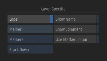

Burning-in Marker Information to Clips
You can display the content of Markers over images using the Player's Metadata Overlay, or burn it in the image using the Burn-in Metadata Timeline FX.
This is achieved by adding the Marker layer to the Information list of the Burn-in Metadata tool.
Once "Marker" is selected, you can do the following:
  • Select whether to burn-in the content of the Markers or Segments Markers. You cannot burn-in both at the same time, on the same layer.
  • Enable the Show Name and Show Comment buttons to burn-in the Marker's Name, Comment, or both.
  • Enable the Use Marker Colour button to burn-in the metadata in using the colour of each marker in the clip.
You can display more than one marker at once in a Burn-in Metadata layer. Lines are automatically added to the Marker layer when multiple Markers or Segment Markers are available at the same time. It is possible to control whether the layers are added towards the top or the bottom using the Stack Up and Stack Down options.
Note: Markers and Segment Markers cannot be displayed on the same layer. Two layers are required to display Markers and Segment Markers at once.
