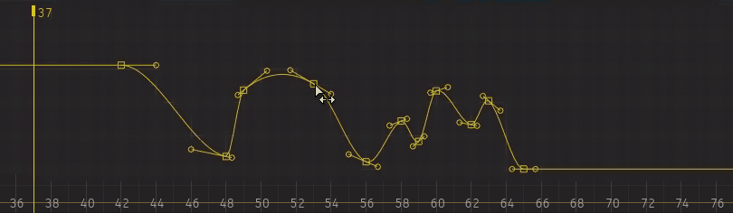

To change the duration of an animation in the Curves view:
  1. In the Animation menu, click to display the Curves.
  2. From the Tools drop-down, select X Scale.
  3. Select the keyframes or channels you want to scale.
  4. Click to frame the curve.
  5. Click the keyframe that will act as the centre of the X Scale. Drag left to decrease the value or drag right to increase the value of the other keyframes along the X-axis, relative to the selected keyframe.
    Using X Scale to change an animation duration
