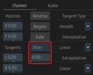

Jitter removes jitter from an animation curve or within a selection of keyframes. Use the Jitter value field to specify the Over value.
As a general rule, start with a large Over value over n frames to remove slow jitter, and a small Over value to remove fast jitter. The Jitter option is typically used on shift data in the Stabilizer to remove jitter while keeping camera movement. See Removing Jitter While Keeping Overall Motion.
To remove jitter:
  1. In the Animation menu, click to display the Curves.
  2. Select a curve or group of keyframes.
  3. From the Curve Functions drop-down, select Jitter.
  4. In the Curve Value field, enter the Over value.
