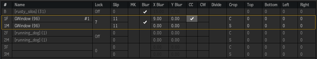

The Media list allows you to easily add and edit the following effects and tools to your clips. The same media can be applied to multiple surfaces, so any effects that you apply to one instance of media is applied to all the surfaces for that media. For example, if you blur media, all of the surfaces using that same media are blurred.
Note: If you are looking for Shadow Softness settings in the Media list, they can now be found directly in the Shadow menu, allowing you to set shadow softness by object, instead of by media.
The effects and tools in the Media list appear from left to right in the order that Action processes them:
Lock and Slip
Use Slip to create a timing offset for your clip and Lock to lock media at a certain frame.
  1. In the Media list, drag the slip field for your chosen media.
    A positive value starts the clip at the specified frame. A negative value creates a freeze frame effect where the first frame of the clip is held by the specified number of frames.
  2. To lock the media at a certain frame, drag the Lock field to the desired frame number, or click the Lock field to display the calculator to enter a frame number. Ctrl+Alt click the field to return it to Off.

To crop a clip with the Media list:
  1. In Action, click Media.
  2. Set values for cropping and softness in the Top, Bottom, Left, and Right fields. Once you set a value in one of the Crop or Softness fields, white checkmarks indicate that Crop and Softness are enabled.
    (a) Softness area of Crop field (b) Crop area of Crop field
    Tip: Alt-drag over one of the fields to change all four values proportionally.

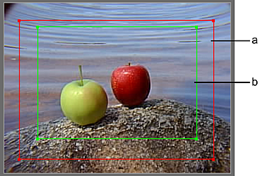

To crop gesturally in the image window:
  1. Double-click the Crop field to enable Crop and Softness.
  2. In the View drop-down, select Media Front or Media Matte.
    The clip appears in the image window with a red outline, which indicates the Crop box, and a green outline, which indicates the Softness box.
    (a) Crop box (b) Softness box
    Tip: You can use two viewports to view the crop interactively on both the front and the matte clips.
  3. Set the corners of the Crop box and Softness box by dragging either the corners or edges of the red and green outlines.
    The crop and softness values in the Media list are updated as you drag.
  4. Click Result.
    The cropped media appears in the image window, and the front and matte clip share the same crop.
