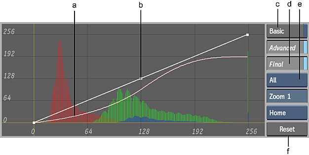

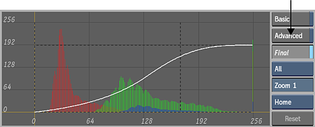

  1. In the LUT Editor, click Advanced.
    Additional advanced editing curves appear for the red, green, and blue channels. RGB curves use blending to distinguish overlapping curves. For example, when all RGB curves overlap, a white curve is produced, whereas green and blue overlapping curves produce a cyan curve.
    (a) Red, blue and green overlapping advanced editing curves (b) Control point (c) Basic button (d) Final button (e) Edit Curve box (f) Reset button

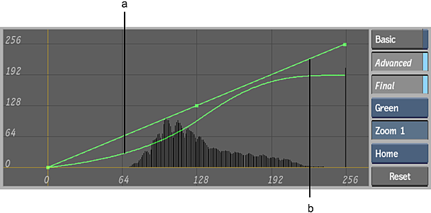

  2. To adjust the R, G, and B curves more easily, select one of the channels from the Edit Curve box.
    The corresponding channel's basic and advanced editing curves are displayed. The histogram only displays values for the selected channel.
    (a) Colour channel selected in Edit Curves box (b) Colour channel's advanced editing curve
