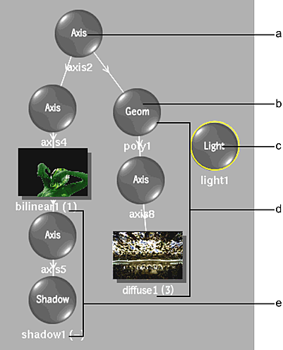

In Action Schematic view, a node exists for all objects in the scene, for example, shadows, lights, and texture maps.
(a) Axis object is the parent of axis 4 and poly1 (b) 3D model (c) Light source (d) Diffuse texture applied to the 3D model (e) Drop shadow of bilinear1
