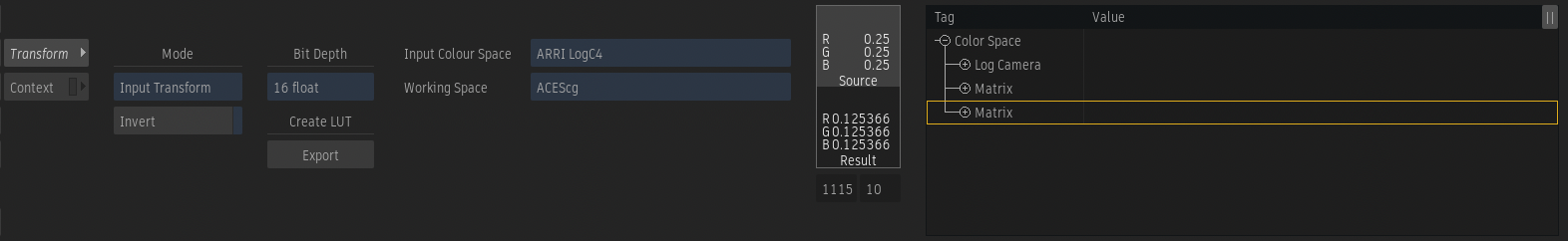

The Input Transform tool allows you to convert from an input colour space to a working colour space (or vice versa). The Input Transform tool in Timeline or Batch is equivalent to the Auto Convert mode in MediaHub.
The processing for this tool is provided by an OCIO ColorSpaceTransform.
To use the Input Transform tool:
  1. Select a source or input colour space from the Input Colour Space menu. In Batch or the Timeline, select "From Source" to have the input space set automatically from the tagging of the input clip. In MediaHub, select "From File or Rules" to automatically set the input space from the file metadata or the Input Rules.
  2. Select a destination working colour space from the Working Space menu. In MediaHub, select "From Project" to have the working space set automatically from the project default.
By enabling the Invert button, you are able to convert from a working space back to an input space. This is useful when you need to deliver material in the same colour space as the original.
The metadata panel on the right provides detailed information about the colour processing operators that will be used to perform the requested transformation.
