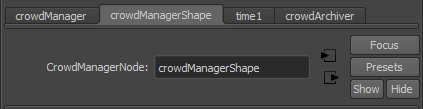

The Crowd Archiver handles Maya "Archive Scene" feature for scenes including Golaem Crowd nodes and assets. This node is in charge of saving all Golaem Crowd files when a user clicks on menu item File > Archive Scene. It can be found in the Crowd Manager Attribute Editor view, as a depending node tab.

The Crowd Archiver node is automatically created at same time than the Crowd Manager.

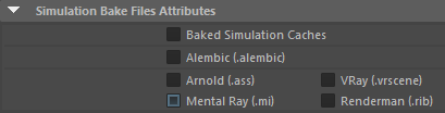

Simulation Bake Files Attributes
Baked Simulation Caches Archive Simulation Cache Files exported by the Simulation Baker (default to false, for file size reasons).
FBX Export (.fbx) Archive FBX files exported by the Simulation Baker(default to false, for file size reasons).
Alembic (.alembic) Archive Alembic files exported by the Simulation Baker(default to false, for file size reasons).
Arnold (.ass) Archive Arnold renderer .ass files generated by the Simulation Baker
VRay (.vrscene) Archive VRay renderer .vrscene files generated by the Simulation Baker
Renderman (.rib) Archive Renderman .rib files generated by the Simulation Baker
