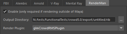

This tab lets you export the parameters stored in a Crowd Render Proxy node as an RenderMan / Guerilla rib file. The generated rib file contains the call to the Golaem procedural plug-in (no geometry is stored in the generated rib files) and is only required to render Golaem Crowd Simulation with a Stand Alone renderer (see Rendering with Renderman Studio to render from Maya). More information about the generated file format can be found here.

| Enable | Enable / disable the RenderMan rib file export. Each selected Crowd Render Proxies will be exported as a RenderMan rib file. |
| Output Directory | Directory to which to export the rib files. |
| Render Plug-in | Specifies if the rib file will be rendered with RenderMan or Guerilla Render |
