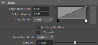

Ramp
The curve ramp defines the continuous noise function to return in an expression code. The returned value is different for each Entity and varies between -1 and 1 (but can be rescaled with the Output Min and Output Max) :
Per Entity Random If checked, the curve ramp will be evaluated differently for each Entity
Is Dynamic If checked, the curve ramp will be evaluated at each frame and may return a different value
Evaluation Mode
Evaluation mode of the ramp. Speed of the ramp evaluation will be computed based on the Duration parameter.
Only relevant if Is Dynamic is enabled:
  • Noise: the curve ramp will be evaluated non linearly (may go forward or backward)
  • Loop: the curve ramp will be evaluated linearly and loop back to the start when reaching the end
  • Once: the curve ramp will be evaluated once and will always return the last value when reaching the end.
Duration Frequency of the curve ramp evaluation. Only relevant if Is Dynamic is enabled:

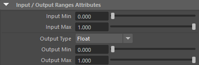

Input / Output Ranges Attributes
Input Min Bound the input value between Input Min and Input Max
Input Max Bound the input value between Input Min and Input Max
Output Type Round / Floor / Ceil to an integer the return value
Output Min Rescale the output value between Output Min and Output Max
Output Max Rescale the output value between Output Min and Output Max
