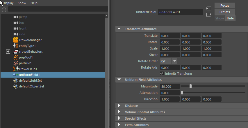

Start with an empty behavior for the entity, and a uniform field on the particles to move them in the desired direction.
Entities should now be moving in the correct direction, but with no animation on it.

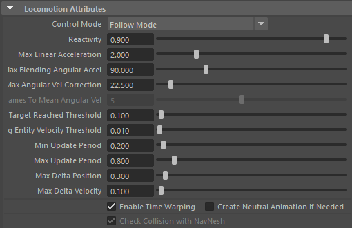

Next step is to add a Locomotion behavior and add the single animation file that should be played on the character. The following attributes should be changed:
- "Create Neutral Animation If Needed" attribute in the Locomotion Attributes should be unchecked;

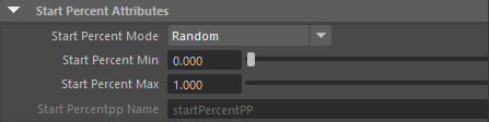

The start percent attributes should also be configured to obtain the desired animation diversity (either with a random, or with pp attributes)

To fix this, the uniform field's magnitude have to be corrected to ensure the particles are always going at the same speed or faster than the animation (it's not a problem if the particle's are going faster than the animation, so there is no need to try to match the exact same speed than the animation's speed).
A uniform field magnitude of 60 is enough in my case to ensure that the
particle is moving faster than the character

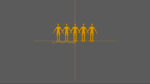

That's it, our characters are finally moving all straight forward with
different start frames
