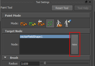

6. Double click the Paint Tool icon  to open the Paint Tool menu and click the Vector Field icon .
7. Select the paintable area in the viewport and click the new button in the Paint Tool window. This will create the Vector Field node.

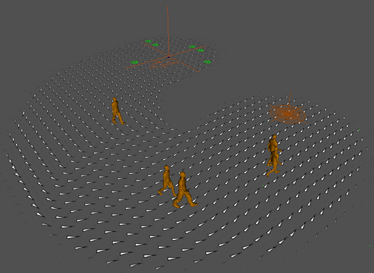

8. Adjust the size of your brush (b) and paint the vectorfield on the paintable object.

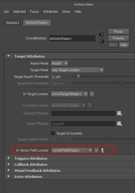

9. Once you are happy with the result open the Goto Behavior attributes and map the Vector Field in the Vector File section:
10. Play the simulation, the entities will go to the target following the Vector Field direction.

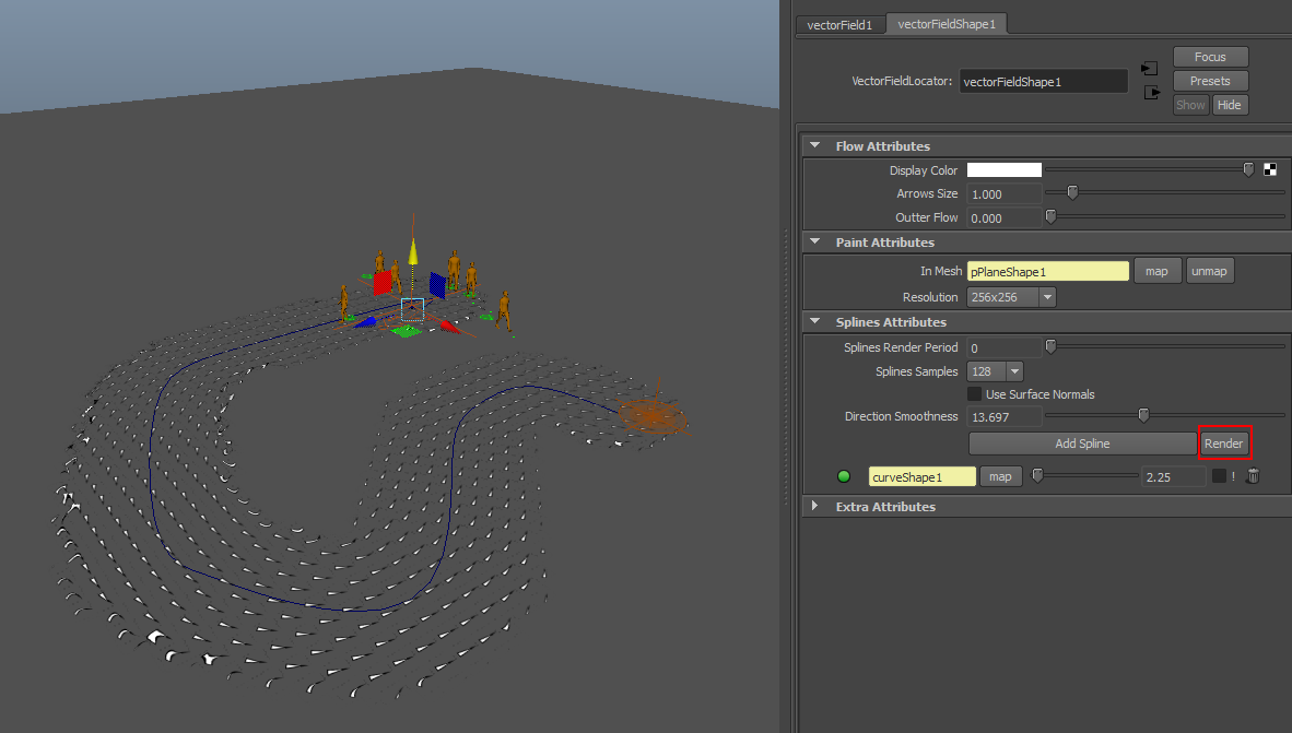

11. Draw a curve in the in the desired direction to the Target.

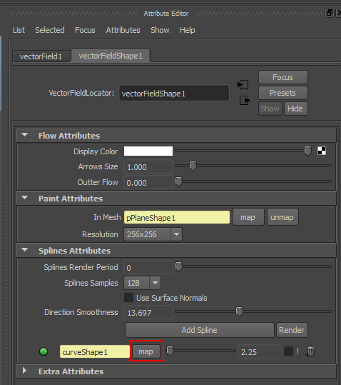

12. Select the curve, hold SHIFT, and in the vectorfield field node attributes editor, click the Add spline to map the curve.
13. Hit Render, the vectorfield is created following the spline.
