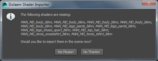

If shaders listed in the Character Maker are missing in the scene, the following dialog will pop-up:

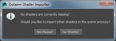

If no shaders listed in the Character Maker are missing in the scene, the following dialog will pop-up:
Aswering "Yes" will display a file dialog to load a Maya scene containing the required shaders. It is also possible to use the Check Render Settings Tool to see which shaders are missing in the scene.
Once loaded the corresponding geometry will be assigned to a Maya group called glmShaders
