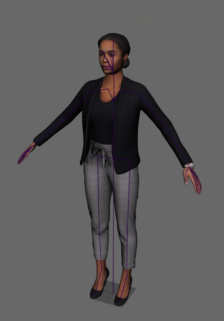

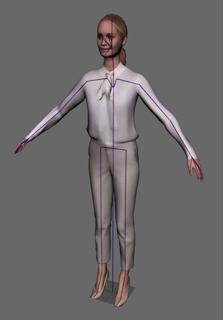

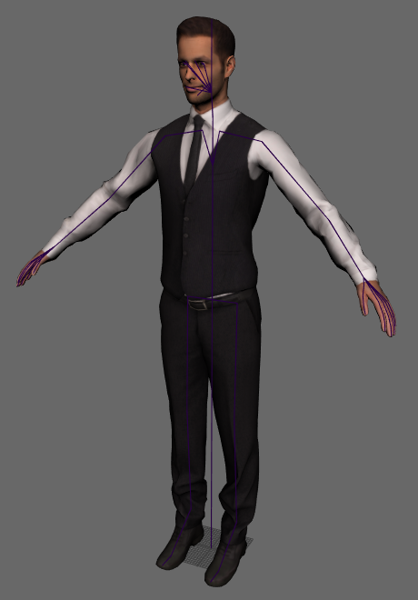

Let's start by importing some characters downloaded from the Renderpeople website:
Example of Renderpeople characters imported in Maya (needs to be rigged)

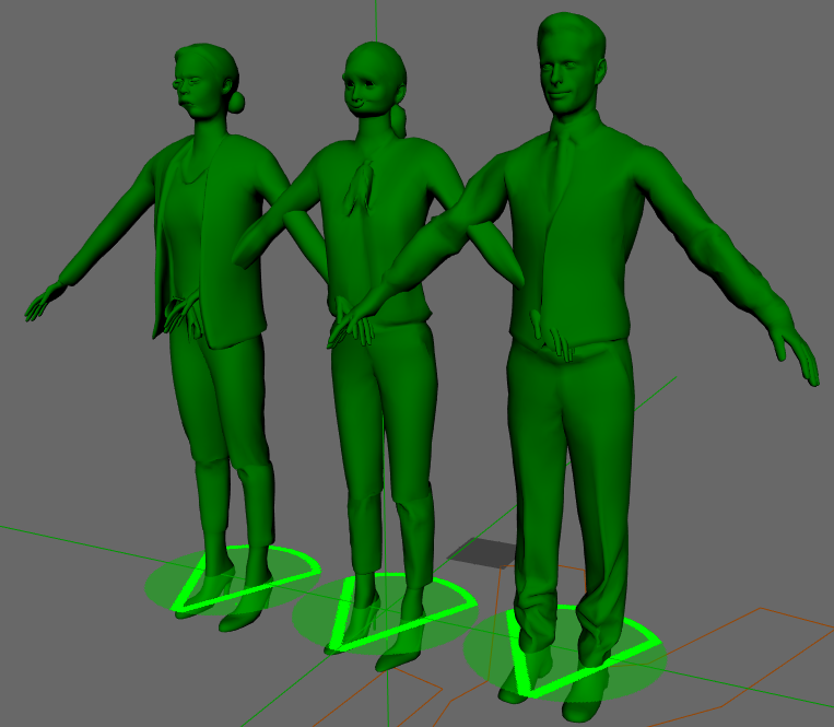

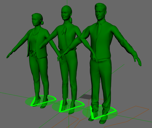

When all shown together, it's obvious that the skeletons have different morphologies (even if they share the same bone names and hierarchy):
Different morphologies for each character*

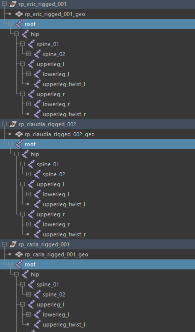

The important thing before going further is to make sure that all characters do share:
- the posture (despite the different morphology)
- the skeleton hierarchy
- the bone names

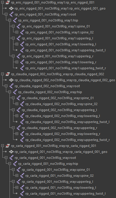

In our case, we imported the characters with namespace, so we need to remove them to make sure the bone names are the same for each character:
Skeletons with (left) and without namespace (right)

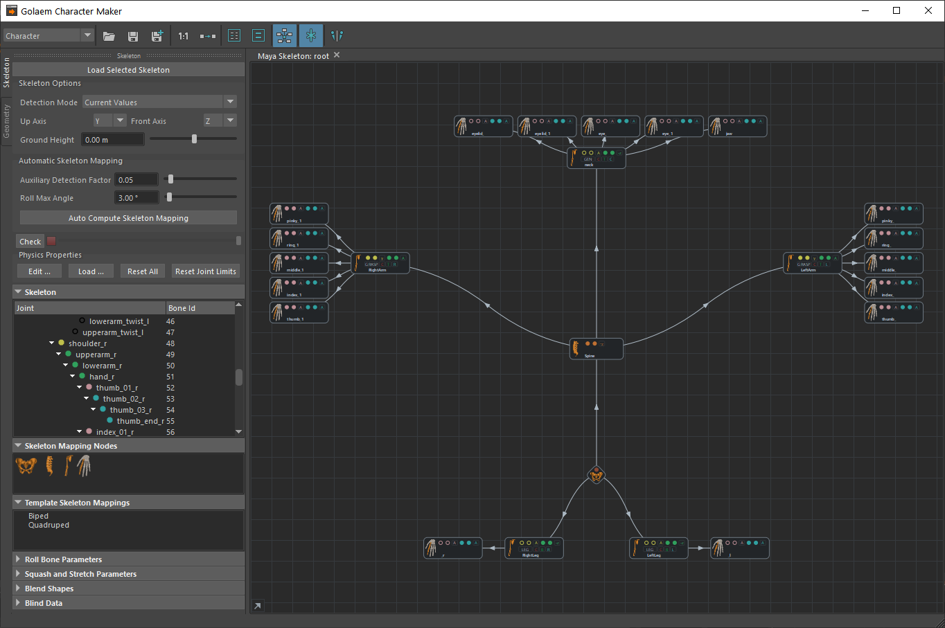

It's now time to import the characters in Golaem. Open the Character
Maker
and load one of the root
skeletons. Hit the Auto Compute Skeleton mapping for a first rough
definition of the character's skeleton mapping.
It's important to load the skeleton with the Detection Mode set to "Current Values" for a correct detection of skeleton overrides in the next steps of this tutorial.
Auto Compute the skeleton mapping with the RenderPeople character

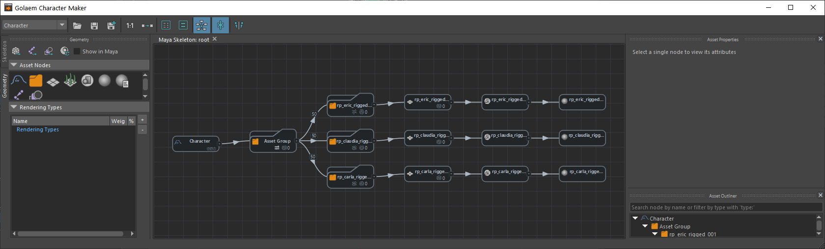

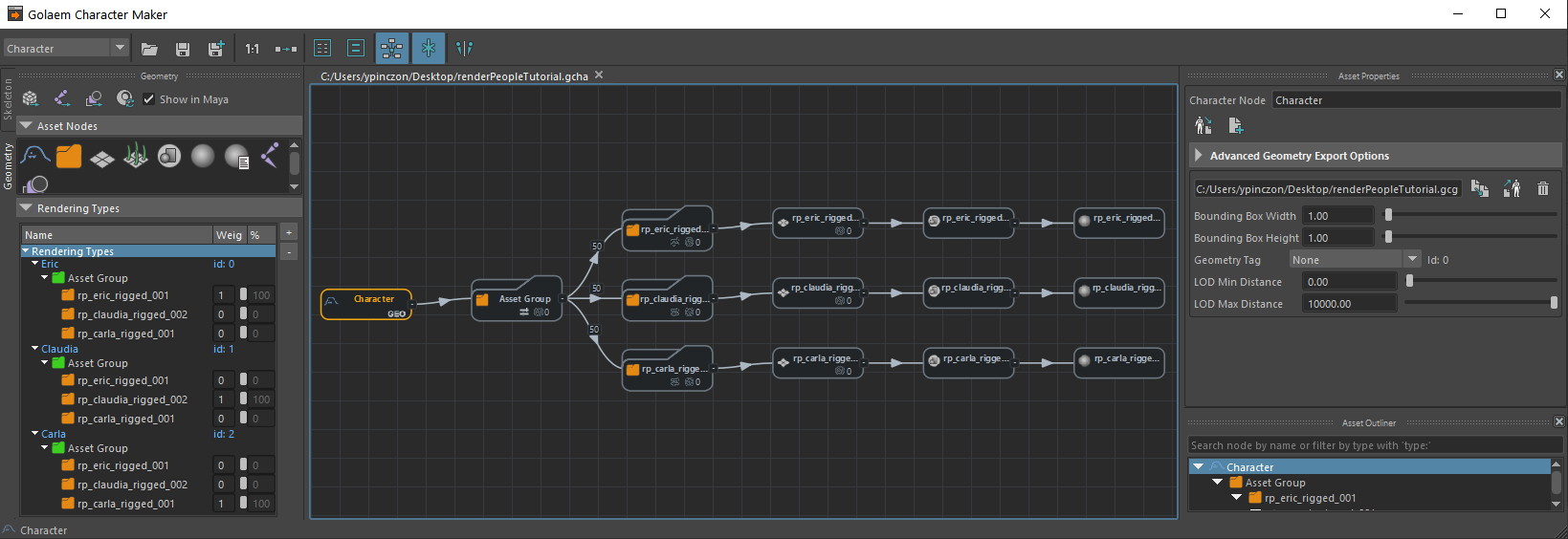

Add a few Asset Groups nodes and link them altogether until you have
the following graph:
The geometry nodes graph after importing the geometry for our 3
characters
Important notice : one character can only use one skeleton, with one skeleton override. Mesh and fur props (hairs, accessories, etc) cannot be shared among several characters, because they would need a different override than the character they are attached to, which is not handled.
Set the rendering types, select the Character node and export the geometry file:
Redenring types and .gcg file

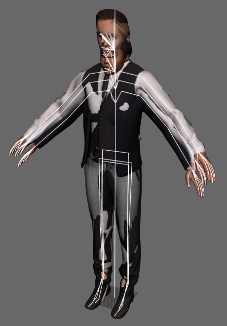

If you save your .gcha character at this step, and try to use it in a simulation, one of the character will be displayed correcly, but all others will be badly skinned:
Wrong skinning results

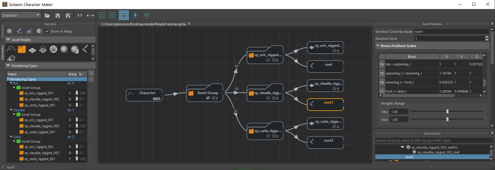

To fix this, we will now import the skeleton overrides for each character.
Select the root node of one of the Renderpeople character in Maya, and
click the Import Skeleton Override
button
in the
Geometry tab of the character maker. This should import a Skeleton
Override node named from the root bone. Link it with the correct asset
node, and do this again for each character:
Importing the skeleton override for each character
