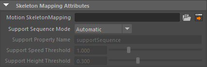

Skeleton Mapping Attributes
| Motion Skeleton Mapping | Golaem character file (.gcha) to use when do the mapping of an animation on another morphology |
| Support Sequence Mode | Method to extract the support sequence in the animations:
| Support Property Name | Property name storing the support phase for each leg (should be >0.5 when on support, <0.5 when on fly). |
| Support Speed Threshold | Speed of a Limb's end bone under which a foot support is detected |
| Support Height Threshold | Height of a Limb's end bone under which a foot support is detected |
