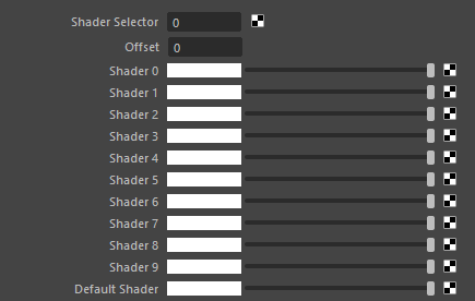

Configuration
| Selector | Value determining which input will be used. It is usually linked to a value which changes for each character (e.g. RedshiftUserDataInteger), hence creating the diversity |
| Start Offset | Value substracted from the selector value when choosing the shader. It is used to create chains of Switch Shaders when more than 10 inputs are needed |
| Default | Default shader to use if no shader corresponds to the Selector value |
| Shader 0 to 9 | Input shaders/textures slots corresponding to the Selector value (e.g. if Selector value is 0, Shader 0 will be returned as output) |

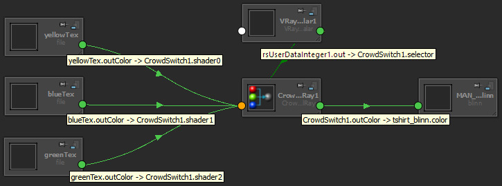

This shader can be used to feed a color attribute of any other shader. The output attribute of this shader is called outColor.
In the following example the Crowd Switch Shader has 3 textures connected to its 3 first Shader slots. Its Selector value is fed by a Redshift RedshiftUserDataInteger shader and its output is connected to the Color attribute of a Blinn Tshirt shader.
