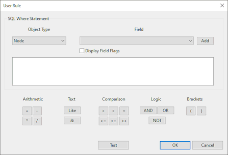

This dialog is used to create and edit user defined validation rules.
The dialog is launched from the User Defined Page of the Validation Editor , and is displayed whenever you create a new rule, or if you click the Edit button in the right hand column for an existing rule.
The editor is fairly self explanatory. A list of network objects is contained in the Object Type field while Field contains a list of data fields applicable to the selected type of object. SQL like expressions can be set up using the Field list and the various operator buttons. Values to test against should be typed in manually. You can, if you wish, type entire expressions into the 'Expression' box.
Use the Test button to check the syntax of the expression you have entered.
