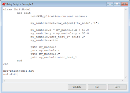

This editor lets you view and edit a Ruby script, validate its syntax and run the script in the current network in the GeoPlan.
It is displayed when you open a Ruby script.

Editor description
Item Description
Content pane Displays the Ruby script code.
Note: This pane is empty for a new Ruby script so you can add the relevant code. See Introduction to Ruby Scripting in InfoWorks for general information about using Ruby scripting in InfoAsset Manager.
Tip: Basic editing functions such as copy and paste are available from a right-click popup menu.
Validate Checks the syntax of the Ruby script.
If the script fails the syntax validation, a message is displayed indicating any errors.
Run Runs the Ruby script in the current network and exports all Ruby scripts in the Asset group to your local working folder.
If the Ruby script uses the require_relative command to reference other scripts in the Asset group, these are run in the order they are listed in the opened script.
If run successfully, a Script output window is displayed, listing the changes that have been applied.
Otherwise, a message is displayed that indicates the likely error and the name of the file that the 'failed' script is exported to.
Save Enabled when you edit the script.
Saves any changes and closes the editor.
