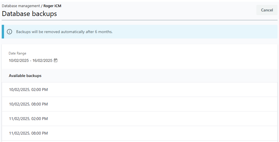

The new backup system is automatically performed by the application, and are incrementally done twice a day. This does not require any user intervention. Also, backups are available for six months, which is longer compared to earlier versions of the application.
Manual and scheduled backups in earlier versions have been replaced by this system. Compared to before, you will not be able to back up on demand. When you make a critical change in your database, you will have to wait until the next incremental backup to have that change backed up.
Another enhancement is the Date Range option, which allows you to filter the display to only a specific start and end date.
This page also allows you to restore any of the available database backups. See Restore a backup for detailed instructions.
