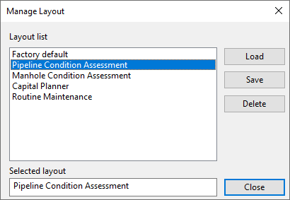

Manage Layouts Dialog
Manage Layout Dialog
This dialog is displayed when you select the LayoutManage layouts option from the Configuration menu on the Object Properties Window Toolbar.
It is used to manage database layouts for the Object Properties Window. It allows you to select a layout to be loaded, saved or deleted.
Dialog description
Item
Description
Layout list
A list of all defined layouts. When a layout is selected from the list, its name will appear in the Selected layout box.
A Factory default database layout is available for selection in the Layout list box. This layout consists of unmodified layouts or factory settings for all objects in the database.
Selected layout
This is used to display the name of the layout currently selected in the Layout list , or to specify the name of a new layout.
Load
Loads the layout, whose name is displayed in the Selected layout box, from the database.
Note: Loading a Factory default will reset all local layouts back to their factory settings. Saved database layouts will not be reset. See Using the Object Properties Window for information about database and local layouts.
Save
Saves the layout, whose name is displayed in the Selected layout box, to the database.
Delete
Deletes the layout, whose name is displayed in the Selected layout box, from the Layout list. Note that the Factory default layout cannot be deleted.
Close
Closes the window and saves any changes.
See Using the Object Properties Window for information about using this dialog.
