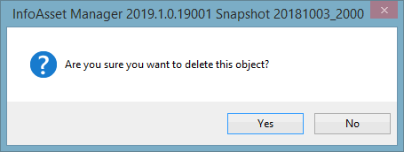

Deleting objects
To delete an object
- Right click the object to be deleted in the tree view.
- Select Delete from the context menu.
- A message is displayed, asking the user for confirmation:
- Click on Yes to proceed.
- The object is deleted.
