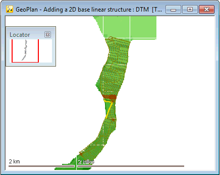

  3. Drag the Adding a 2D base linear structure network onto the main window.
  4. Drag the DTM ground model imported in an earlier exercise onto the main window.
    Starting point of this tutorial

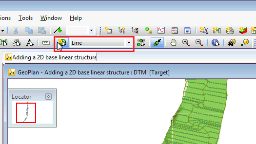

  5. The first step is to add a 2D base linear structure into the 2D zone. These structures can be used to represent walls or dams that stop the flow of water within a 2D zone. The base linear structure we are going to put in is a wall that will collapse partially during the simulation using flood depth as wall removal trigger. First, draw a line in the 2D zone and define it as a 2D base linear structure:
    1. From the New Object toolbar item, select Line as the required object type. Then select the New Object button .
    2. Creating a new line

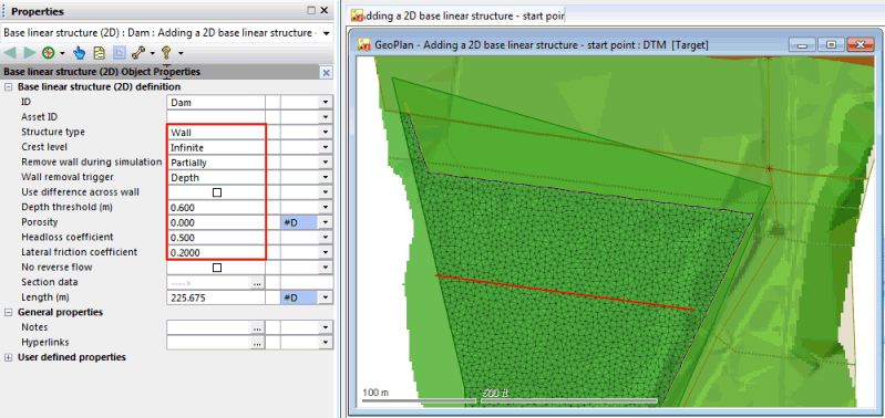

  7. Next, use the Properties tool , select the 2D base line and set the various parameters required. In particular, set the Structure type to Wall and the Crest level to Infinite. Set the Remove wall during simulation field to Partially and Wall removal trigger to Depth.
  8. A wall can be set up for either never collapse, partially collapse (the segment of the wall adjacent to the mesh element in which the condition has been met will collapse) or fully collapse, in which the entire wall collapses, as soon as the condition is met, at any point along the wall. In this tutorial, we use Depth as trigger to remove wall during simulation, set Depth threshold (m) to 0.6 and Porosity to 0. A porosity of 0 is equivalent to a vertical wall which does not allow flow to transfer through it.
  9. All other parameters should be set as in the image below (Headloss coefficient set to 0.5 and Lateral friction coefficient set to 0.2).
  10. Dam Properties

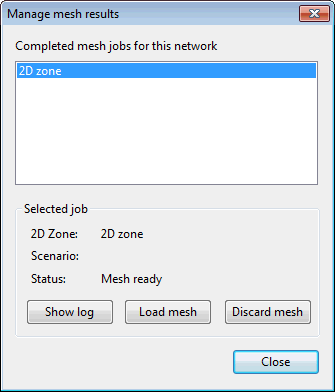

    5. The 2D mesh can now be loaded into the model. Select Meshing Load mesh job results… from the Model menu. In the Manage mesh results dialog, select 2D zone from the list and click on the Load mesh button.
    6. Click Close to close the dialog.
    Load the mesh to the network

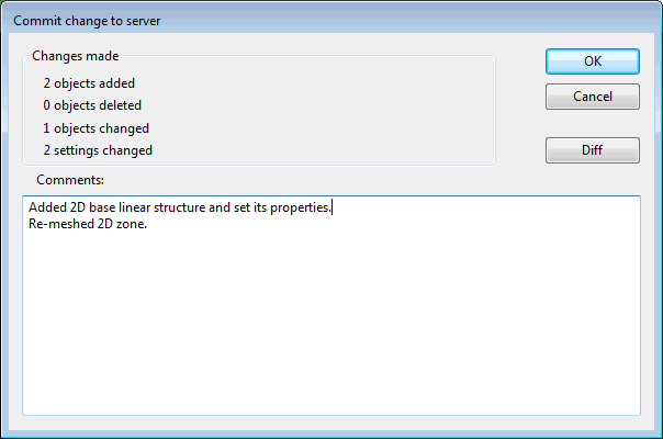

  13. Changes made to the network must now be committed to the dtabase so that they become available to other users.
    1. In the Explorer window, right-hand click on the Adding a 2D base linear structure network and select Commit changes to database.
    2. The Commit change to server dialog is displayed.
    3. Type in any notes as appropriate.
    4. Commit change to server
    5. Click OK to commit the changes and close the dialog.

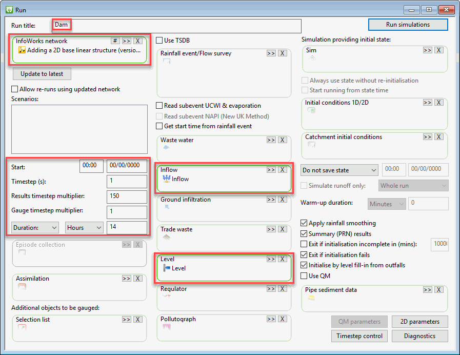

  14. Create a new run and define the run parameters as shown in the screenshot below:
    1. Create a new run by right-clicking the Model Group in the Explorer window.
    2. Select New InfoWorks Run. The Schedule Hydraulic Run View dialog is displayed.
    3. In the Schedule Hydraulic Run View dialog:
      1. Enter a name in the Run title (Dam)
      2. Drag and drop your network (Adding a 2D base linear structure) in the InfoWorks Network drop target.
      3. Drag and drop the Inflow hydrograph in the Inflow drop target (This hydrograph has been added to the model in step 5 of the Building a river model in InfoWorks ICM mini-tutorial).
      4. Drag and drop the Level hydrograph in the Level drop target (This hydrograph has been added to the model in step 5 of the Building a river model in InfoWorks ICM mini-tutorial).
      5. Set the Timestep to 1 second and the Results timestep multiplier to 150.
      6. Set the Simulation time to 14 hours.
    4. It is worth noting that 1D-2D models will typically have a lower timestep than 1D-only models. In this example we will be using 1 second, but below 10 seconds is perhaps more common.

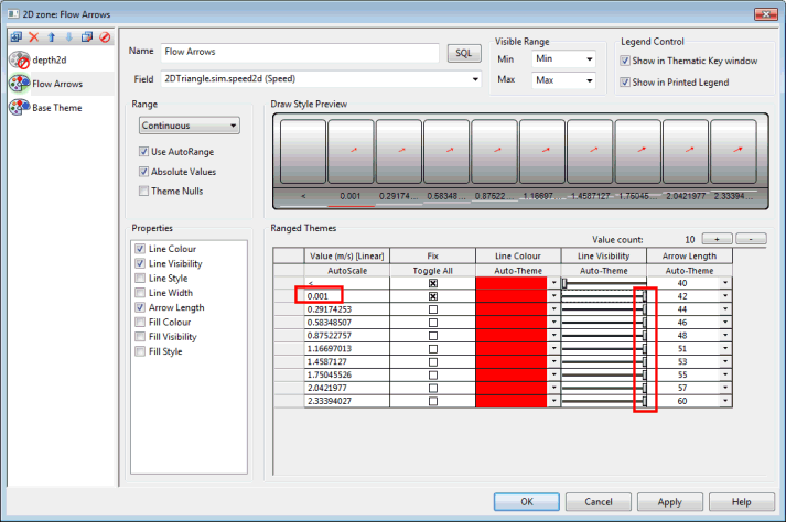

  19. Modify the 2D zone configured in the 2D Zone tutorial so that low flows and depths have a higher visibility. The line visibility is set using the slider in the Line Visibility column. Line visibility is increased (and transparency decreased) by pulling the slider to the right. 100% visibility (and 0% transparency) occurs when the slider is set completely to the right. Do this for all flow values with the exception of negative values. Set the second flow value down in the Ranged Themes grid to 0.001 instead of 0. Click on Apply then OK on the Layer Theme Editor.
    Editing the 2D Zone arrow theme

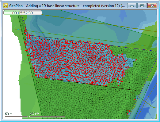

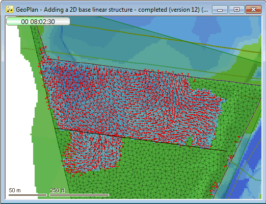

  20. The two following screenshots have been obtained using the modified 2D zone theme (see above) and the same flood theme as described in the 2D Zone tutorial.
  21. Before wall collapse
    Before the wall collapses
    After wall collapse
    After the wall collapses
