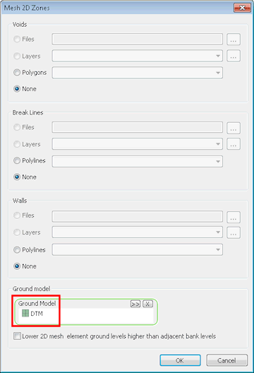

  2. Use the Select tool to select the 2D zone. Then create a mesh by choosing Model | Meshing | Mesh 2D zones. Drag the DTM ground model into the Meshing dialog and click OK.
    Mesh 2D zone dialog

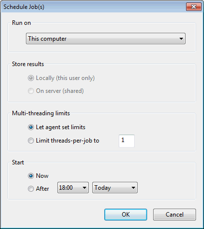

  3. In the Schedule Job(s) dialog, set the mesh job to run on This computer and click OK.

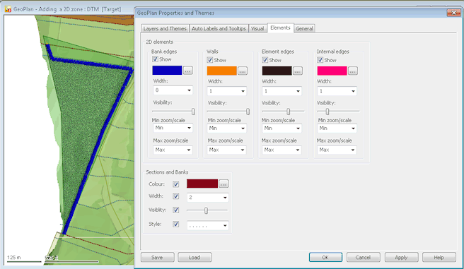

  7. The theme below can be used for bank edges to check that a bank edge is picked up by the 2D mesh.
    2D zone element theme

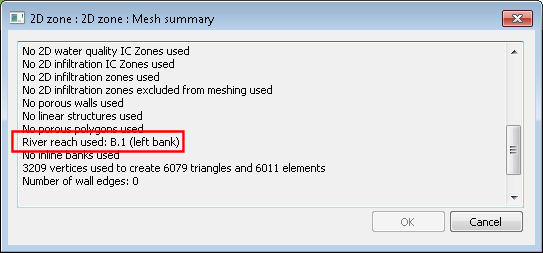

  8. You can also check that a bank edge is picked up by the 2D mesh by looking in the meshing log or the mesh summary viewed from the 2D zone property sheet.
    Mesh summary

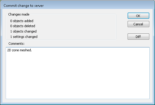

  10. Every time a version-controlled item, such as the network, has been changed, it is good practice to commit the changes. Changes are stored in your own local copy of the network (in your Local Working Folder directory) and must be committed to the database so that they become available to other users. Also, committing changes on a regular basis allows you to discard all the changes you have made since the last time you committed the network to the database.
    1. In the Explorer window, right-hand click on the Adding a 2D Zone network and select Commit changes to database.
    2. The Commit change to server dialog is displayed.
    3. Type in any notes as appropriate.
    4. Commit change to server
    5. Click OK to commit the changes and close the dialog.
