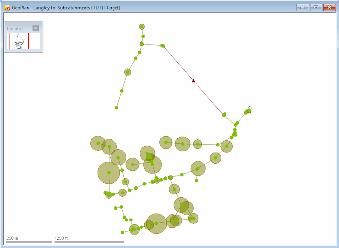

  2. Select the SubcatchmentCreate Dummy Boundaries option from the Model menu.

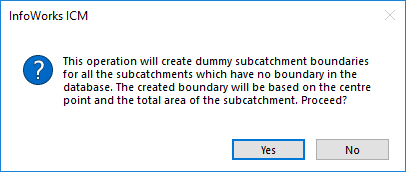

    A confirmation window is displayed.
  3. Click Yes to create the dummy boundaries.
    InfoWorks ICM creates circular boundaries for all subcatchments that do not have boundary information. The area of the circle represents the Total Area of the subcatchment as entered on the grid or property sheet.
The subcatchment boundary can now be edited in the same was as with any other subcatchment.

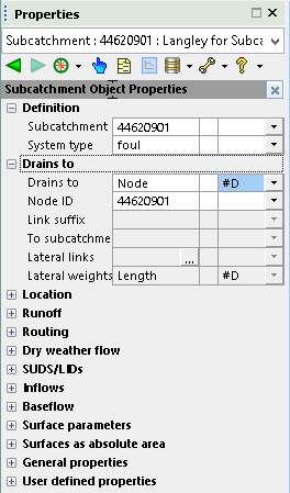

  8. Click OK. The new subcatchment is created and displayed on the GeoPlan, and its property sheet is displayed in the Object Properties window.
    You can enter additional properties on the property sheet now or later. Or you can use the Subcatchments Grid.

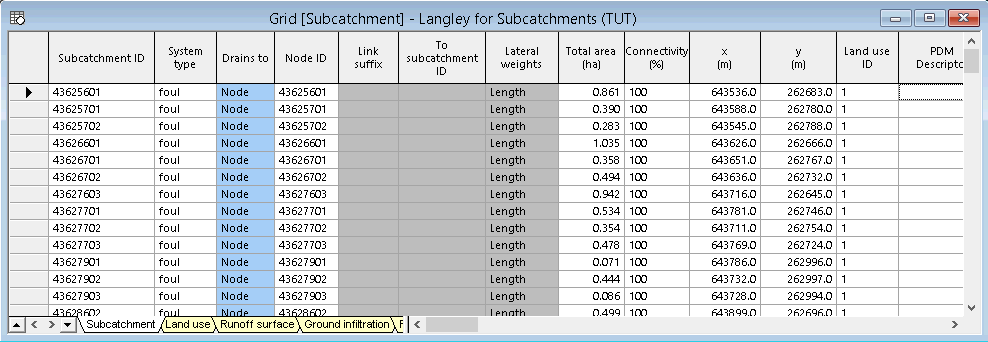

  1. Click the (New subcatchments window) button on the Modelling Grid Windows toolbar. Alternatively, select the Grid windowsNew subcatchment window from the Window menu.
  2. The Subcatchments Grid is now displayed.
    The grid is separated into tabs; the Subcatchment tab is used to define the properties of the subcatchment while the other tabs define the properties of objects, which may be associated with a subcatchment.
  3. Click the Subcatchment tab.
  4. Scroll the grid down until you reach the append row. The append row is marked with a * in the left column. If there is no append row, then the grid may be read-only.
  5. Edit the properties of the subcatchment if required. You can type in names/identifiers for subcatchments you have not yet created. As soon as you start to type the icon changes to . You can add other parameters to the append row now if you want.
  6. To save the new subcatchment, move off the row you are editing by clicking another row in the grid. If the ID is not unique, a message will be displayed. You must type in a unique ID to identify the subcatchment.

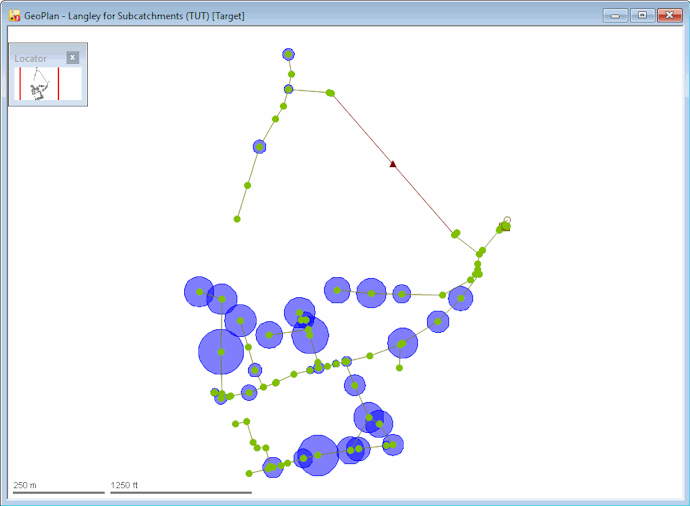

  1. Right-click the GeoPlan and select Properties and Themes from the pop-up menu, and the GeoPlan Properties and Themes window is displayed:
    The parameters in the Subcatchment row in the Layers and Themes tab allow you to edit the display. For example, you can use the Display box to turn the display on and off.
  2. Choose a different colour for the display of the subcatchments by selecting a colour from the corresponding Default Colour drop-down list.
  3. Click OK to accept the change and close the GeoPlan Properties and Themes window.
    If we take the dummy subcatchment boundaries' example at the beginning of this topic ('Langley for Subcatchments' network) and choose a shade of blue as the Default Colour and click OK, the network will look like this:
