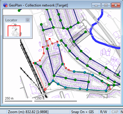

The current snap mode including GIS snap mode state is displayed in the status bar at the bottom of the main window (when snap mode is relevant). Snap mode state is also shown by the state of the toolbar button - depressed means snap mode is on.
Snap mode on with GIS snap mode
