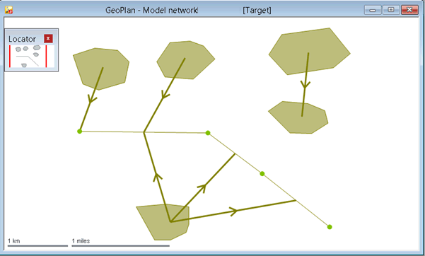

The subcatchment drainage is displayed in the GeoPlan as large arrows.
However, no arrows will be displayed when a subcatchment invalidly drains to more than one inflow node, link, subcatchment or 2D point source.

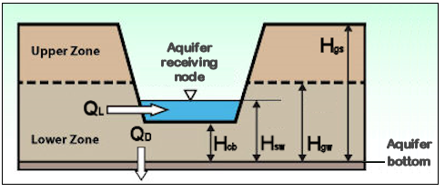

A subcatchment can be associated with an aquifer and a node in the drainage system that exchanges groundwater with the aquifer. By setting the coefficients that determine the rate of lateral groundwater flow between the aquifer and the node, ICM can calculate groundwater flow as a function of groundwater and surface water levels using the following EPA SWMM standard lateral groundwater flow equation:
QL = A1 (Hgw- Hcb)B1-A2 (Hsw- Hcb)B2 + A3 Hgw Hsw
(1)
where:
QL is the lateral groundwater flow
A1 is the groundwater coefficient
Hgw is the height of saturated zone above bottom of aquifer
Hcb is the height of surface water at receiving node above aquifer bottom
B1 is the groundwater exponent
A2 is the surface water flow coefficient
B2 is the surface water flow exponent
Hsw is the height of surface water at the aquifer node above aquifer bottom
A3 is the surface groundwater coefficient
The groundwater flow equation height inputs, in relation to the bottom of the aquifer, are illustrated in the following figure:
