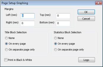

This dialog is used to set up the printing options for a Graph.
it is displayed when you choose Page setup from the File menu when a Graph View is the Current Active Window.
Use the Margins options to control the graph margins.
Use the Title Block Selection and Statistics Block Selection options to control the display of the graph title and statistics table:
  • None - Block will not be displayed in printout.
  • On every page - Title block will be displayed at the top of each graph page. Statistics block will be displayed at the bottom of each graph page.
  • On separate page only - Block will be displayed on a separate page from the graph.
Click Logo to display the Print Setup Logo dialog. This dialog allows inclusion of a user defined title and logo, which will be printed at the bottom of the page.
