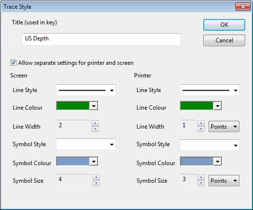

You can change the title, colour, line thickness, and line symbol for a graph trace on the Trace Style dialog.
You can set different properties for on-screen viewing and printing if required. This is achieved by enabling the Allow separate settings for printer and screen option.
It is highly recommended to use points for line width and symbol size when configuring separate printer settings unless defaults were set in versions of InfoWorks ICM prior to version 3.0, for which pixels were the implicit unit.
To access this dialog:
- double-click on any trace on the Graph View
- in the Graph Properties Dialog, double-click on any trace on the Traces Page
- in the Custom Graph View, double-click on any trace on the Traces Page
The options on the dialog are self-explanatory.
It is not possible to edit the trace titles for observed (rainfall, depth, flow and velocity) events for Observed/Predicted reports.
