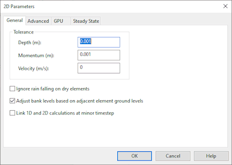

This dialog is used to view and edit tolerance parameters and advanced parameters for use in 2D simulations, and is displayed when you click 2D Parameters on the Schedule Hydraulic Run View (InfoWorks).
The items included in each tab are described in the following sections.
General
Parameter |
Description |
Depth |
Depth threshold used to determine whether to consider a mesh element wet or dry. Mesh elements with depth of water below this value will be considered dry and a zero depth will be displayed in the results. Only mass conservation will be considered in elements with depth below this threshold. Typical value: 0.001 m Default value: 0.001 m |
Momentum |
Depth threshold used to determine whether to consider momentum in a mesh element or not. Movement of water will not be calculated for mesh elements with depth of water below this value; only mass conservation will be taken into account. Typical value: 0.001-0.01 m Default value: 0.001 m |
Velocity |
Velocity threshold. Mesh elements with water velocity below this value will have velocity reset to zero in terms of momentum calculations. Typical value: 0 m/s Default value: 0 m/s |
Ignore rain falling on dry elements |
If this option is checked, rainfall and evaporation applied to the 2D mesh will only be applied to 'wet' elements in the mesh. Default value: unchecked |
| Adjust bank levels based on adjacent element ground levels |
If this option is checked, the level of bank sections that are lower than adjoining mesh elements will be adjusted by the engine to match the mesh element ground level. Note that it is possible during mesh generation to adjust the ground level of mesh elements to match the adjoining bank level. Default value: checked |
| Link 1D and 2D calculations at minor timestep |
If this option is checked, the 2D simulation engine will perform calculations at every minor timestep. If this option is unchecked, 2D calculations will be performed at every run timestep. Using this option may help in reducing the occurrence of oscillations at banks for some networks. Default value: unchecked |
