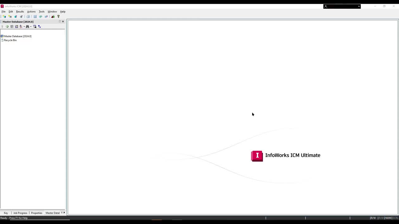

Open/Create dialog
To simplify the process of selecting which type of database you want to open, create, update, or get the identifier for, a new Open/Create dialog has been added to InfoWorks ICM. When you have chosen the type of database, the Open Master Database dialog relevant for your selected type is displayed. See Master Database for further information.

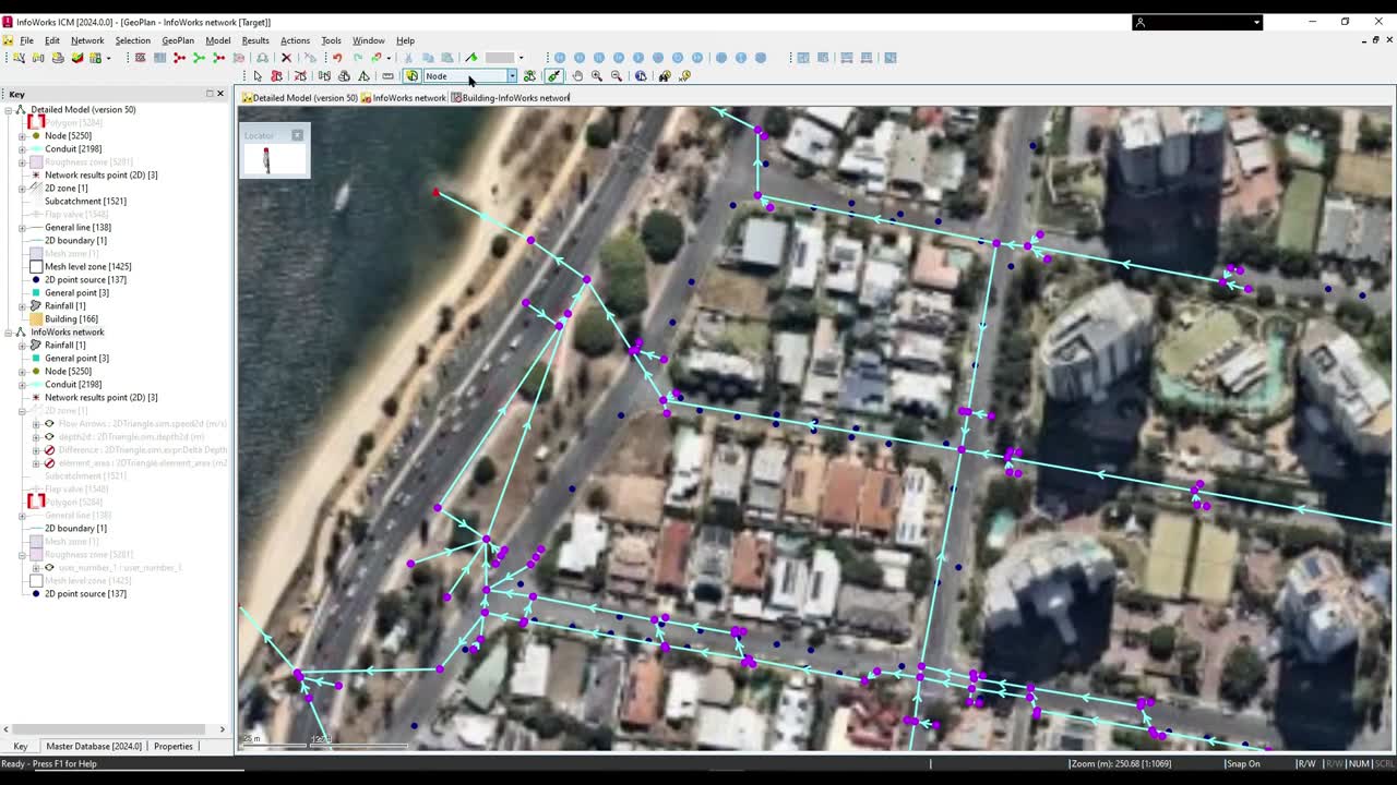

Buildings *
A new polygon object, Building, is now available in InfoWorks networks. This type of object can be used to represent rain falling onto the roof of a building and entering the drainage system and/or remaining on the surface.
You can model the impact of SUDS structures, such as green roofs, on storm runoff entering the drainage system by assigning SUDS controls to buildings. You can also set a capacity limit, where any flow above this limit is capped from entering the 1D network, and you can select whether this excess is lost from the system or passed to the 2D mesh elements surrounding the building. If passed to the 2D mesh, the building's boundaries will be enforced as break lines during mesh generation.
You can choose whether or not the building is to be represented as a single element in the mesh and you can adjust the ground level of a building's 2D mesh. Porosity and roughness can also be defined for a building, which will also be applied when you create a 2D mesh. See the building properties for further information.

In order to distinguish buildings in the GeoPlan, a default theme is available, which you can edit as required. Building drainage can also be displayed as large arrows if you have checked the Show subcatchment, building and 2D permeable zone drainage arrows box on the Visual tab of the GeoPlan Properties dialog.
Simulation results for buildings are displayed on the results grid and on the Building Property Sheet while viewing a replay of a simulation.

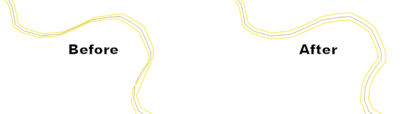

Improvements to bank line created from section ends for meandering rivers
When using the Create bank lines from section ends option, and you chose to follow the shape of the river reach link, the software now tries to project the banks out from the link line in a way that provides more natural looking bank curves whilst minimising the number of vertices used. A before and after example is shown below:
The bank is projected at a distance that is linearly interpolated from the upstream and downstream sections, with the section distance calculated as the distance between the point that the river line crosses the section and the section end point on that bank side. Projected bank points adjacent to vertices in the river line are added in a direction that is perpendicular to the river line, and on outer bends, a couple of extra beveling points may also be added to improve the shape of the curve. Contractions between banks that are too close and other "oxbow lake"-shaped meanders are simply trimmed out from the location where the banks would have intersected.
You will still need to visually inspect the banks lines to ensure they match the physical reality, and make manual changes to the bank vertices where necessary.

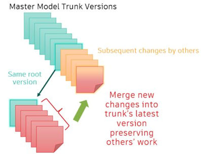

Merge Changes from Another Network *
You can now merge changes from one network into another network so that the differences in one are copied to the other. This can be useful when you have created a branch from a shared model to explore iterative changes to the model. Once the branched copy is finalised, its changes can be merged back into the parent copy while also preserving changes since the branch was created. This process also works across organisations using model copies in transportable databases.
In order to use this new feature, an new option, Merge changes from another network, has been added to the popup menu that is displayed when you right-click on a network in the Explorer window. When this option is selected, a new Merge changes into dialog is displayed, which is used to specify merge parameters and perform the merge.
A summary of the merged objects is displayed in a Review Network Merge report. This reports lists the network objects that have been added, modified, renamed, or deleted after the merge. It also lists any network objects, whose properties have conflicting values, as well as their current and incoming values, and an option to chose which value should be applied to the merged network.
