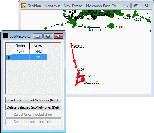

Connectivity Trace View showing a disconnected sub-network selected on the GeoPlan
To carry out a connectivity trace, open a network and then choose GeoPlan Tracing tools Connectivity trace. This displays the Connectivity Trace View, containing a list of the separate sub-networks found, with node and link counts for each.
