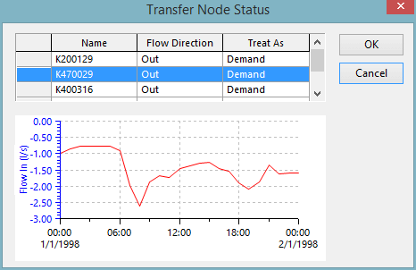

Transfer Node Status dialog
The Transfer Nodes Status dialog is used when carrying out an Isolation Trace or Isolation Analysis.
The dialog is used to view the demand associated with Transfer Nodes in the network and to control whether a transfer is regarded as a demand or a supply.
To display the dialog, click the Transfer Nodes button on the Isolation Trace View / Isolation Analyser View.
