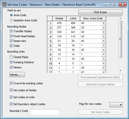

The Set Area Codes dialog is used to Set Area Codes at objects based on the sub-network in which the object is located.
To display the dialog, select Set Area Codes from the Model menu.
The dialog options are:
Option Description
Field to set
Determines which of the area code fields is updated: Area Code or Isolation Area Code.
Default settings are offered when either of the two options is selected. If the default settings are selected, the Bounding Nodes and Bounding Links options will be set as follows:
  • Area Code: open all nodes and links. All options in the Bounding Nodes and Bounding Links section will be unchecked. All valve options will be set to Closed.
  • Isolation Area Code: open nodes and meters; close pumps and valves. Pumps and valves will be used to define isolation areas. All options in the Bounding Nodes section will be unchecked. The Pumping Station option in the Bounding Links section will be checked. All valve options will be set to Always.
Bounding Nodes
The objects checked in the Bounding Nodes section will be considered as boundaries in the network for the purpose of determining sub-network areas.
Bounding Links
The objects checked in the Bounding Links section will be considered as boundaries in the network for the purpose of determining sub-network areas.
Click the Valves button to set bounding valve options from the Boundary Valves dialog. The selection of valve types is more detailed if a Control Data is associated with the network.
Find Areas button
Click this button to search for sub-networks according to the options set in the Bounding Nodes and Bounding Links sections of the dialog.
Area Grid
The Area Grid lists all sub-networks found and allows new area codes for each sub-network to be specified.
Column Description
Nodes
Number of nodes in sub-network
Links
Number of links in sub-network
New Area Code
Dropdown list of all the Area Codes present within the sub-network.
The default area code is the code that occurs most frequently in the sub-network.
Select a code from the dropdown list or type in a code to be applied to sub-network objects when the Set Area Codes button is clicked.
Find Selected SubNetworks (Ret) button
Select one or more rows in the Area Grid (Ctrl and SHIFT keys can be used to select multiple rows).
Click the Find Selected SubNetworks (Ret) button to highlight and zoom in on the objects in the selected sub-networks on the GeoPlan Window, or use the keyboard Return key.
Generate Unique Names
Click the Generate Unique Names button to automatically generate a unique integer based New Area Codefor each of the selected rows.
Overwrite existing codes
Check this option to overwrite any existing Area Code values.
If this option is unchecked, only Area Code fields that do not currently contain a value will be updated.
Set codes at Nodes
Check this option to set Area Code values at node objects.
If this option is unchecked, node objects will not be updated.
Set codes at Links
Check this option to set Area Code values at link objects.
If this option is unchecked, link objects will not be updated.
Set boundary object codes
Check this option to set Area Code values for Bounding Node and Bounding Link objects.
Bounding Object codes will be set to the value entered in the Boundary Code field. The default Boundary Code is blank.
Flag for new codes
Select a user flag to be applied to updated Area Code fields.
Click this button to update the Area Code or Isolation Area Code values of the objects in the sub-networks currently selected in the Area Grid.
Area codes will be updated to the values currently displayed in the New Area Code column of the Area Grid.
