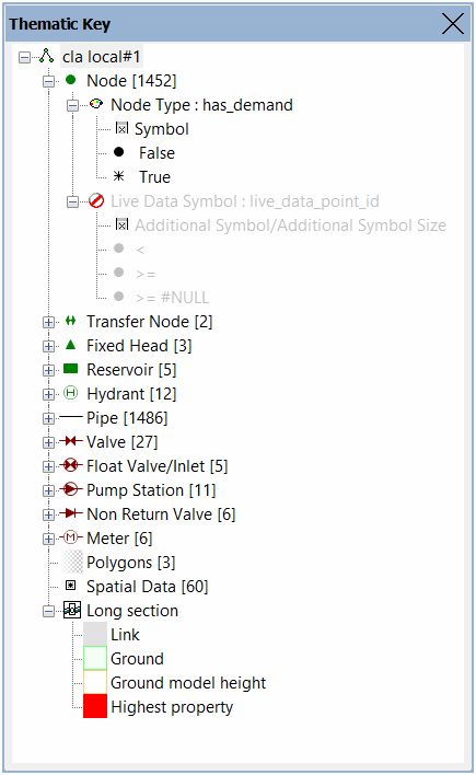

Thematic Key window
This window:
  • provides a visual reminder of the GeoPlan window symbols and current themes for all open GeoPlan windows
  • gives access to the Layer Theme Editor dialog
  • lets you display or hide object types on the GeoPlan
  • lets you disable and enable themes on the GeoPlan
The window is displayed by selecting Window Thematic key window.
This window is a dockable window. You can drag its title bar to make the window free-floating. You can redock it by double-clicking its title bar.
Thematic Key window
The sub theme Live Data Symbol : live_data_point_id is shown as disabled.
Reservoir is shown as not displayed.
