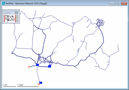

The network is displayed in the GeoPlan view ready for editing.
- A network open in the GeoPlan view can be edited, which is covered
here. Once the editing is complete, the network should be checked for errors. See
Validating the network topic for more details.

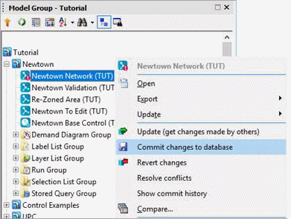

- To commit a network:The icon for checked-out networks has a red border.
- Right-click the uncommitted network icon in the Model Group window and select
Commit changes to database.

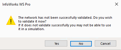

- Do not validate the network at this stage (that is, click
No on the following message).

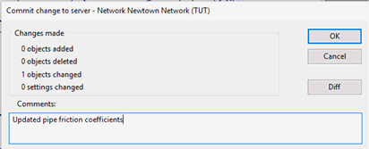

- You are given the opportunity to enter comments relating to the network. Enter a comment and click OK. No other user can make changes to this version of the network until it has been checked in. If you close down InfoWorks WS Pro without checking in the network, it will still be checked out the next time you start the program.
- The network is now committed. To show this, the network icon in the Model Group window no longer has a red exclamation mark (!).
- Close the GeoPlan view by clicking the
button in the top right corner of the window.
