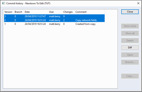

- On the Model Group window, right-click the 'Newtown Edited' icon and choose Show commit history from the context menu.
- In the commit history dialogue, hold
Ctrl and select the two versions to be compared.

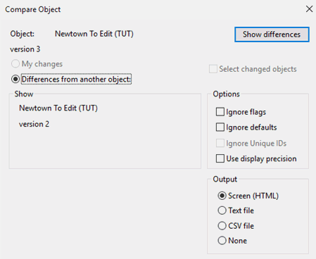

- Press the Diff button to open the Compare Object dialogue. Accept the defaults and click Show differences.

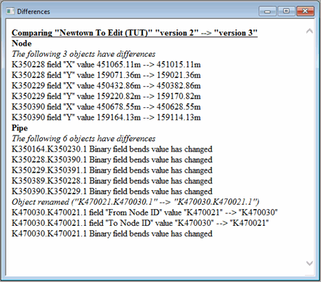

- The comparison report is displayed in a text window and lists all the changes that have been made for each type of object.The table includes a number of changes to default values; for example, where nodes were moved, bends have been recalculated.
- Close the report.

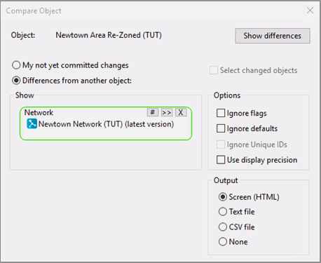

- On the Model Group window, right-click the 'Newtown Area Re-zoned' network icon and choose Compare from the context menu.
Click the Differences from another object check box and select the original Newtown network from the explorer tree.
- Close the report.
