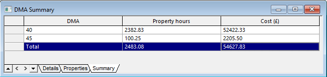

Grid Report (DMA Summary) view
This view provides details of failures that meet a defined minimum pressure criteria for a selected simulation.
The view is displayed by selecting Results Grid reports DMA Summary, then completing the DMA Summary dialog , and then clicking the Produce Grid button. The fields displayed in the report will depend on the report options selected.
Item Description
Summary tab
DMA: Demand Management Area (DMA) ID.
Property hours: Total number of property hours (Number of properties multiplied by the Duration) for a particular DMA.
Cost: Total cost (Property hours multiplied by the Cost per property hour) for a particular DMA.
