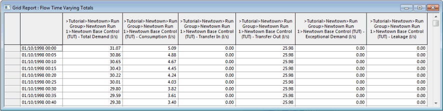

Grid Report (Flow) view
This report displays a summary of the total flows in the system for each timestep.
The report is opened by selecting Results | Grid reports | Flow, system and global summary results and then completing the Grid Report dialog, choosing Flow as the report type.
| Item | Description |
| Column header | Contains the full database location of the simulation (model group, run group, run, simulation). May also contain the title of the data in the column as the final element. |
| Flow report columns |
Total Demand: Total demand from the model. This is the sum of Consumption, Transfer Out, Exceptional Demand and Leakage. Consumption: The total demand* defined at nodes in the node demand grid on the Node Demand page.
*Demand profiles with the leakage option unchecked in the Demand Diagram Editor. Transfer In: Total flow into the system via transfer nodes (Flow Factor = 1). Transfer Out: Total flow out of the system via transfer nodes (Flow Factor = -1). Exceptional Demand: Total demand at nodes defined as exceptional flow on the Exceptional Flow Profile page. Leakage: Total losses from the system due to leakage. This is made up of the total leakage‡ defined at nodes in the node demand grid and the Leakage Loss, both defined on the Node Demand Page.
‡ Demand profiles with the leakage option checked in the Demand Diagram Editor. |
