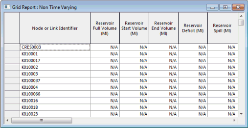

This view displays fixed results (start and end results and maxima) for selected network objects. Each object has one row in the grid. Many of the columns will be inappropriate for some object types. In this case they will be marked N/A (not applicable).
The view is displayed by selecting
Results
Grid reports
Non time varying results and then completing the
Grid Report (Non-Time Varying) dialog.
