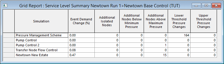

This view displays counts of failures to meet the required service level.
The types of report that can be produced are:
- report on nodes
- report on customer points
Notes:
- If a base simulation is selected, only nodes or customer points that failed level of service criteria in the base simulation, but not in the simulation-to-compare, will be reported in the grid.
- Nodes or customer points that failed level of service criteria in both the base simulation and the simulation to be compared will not be reported, unless the node / customer point fails a pressure threshold criteria.
The view is displayed by selecting
Results
Grid reports
Service level summary, then completing the
Service Level dialog. The fields displayed in the grid depend on the options selected on the dialog.
| Item | Description |
| Service level summary report fields |
Simulation: Simulation name Event Demand Change: Percentage of demand change at Nodes / Customer Points between Simulation and base simulation. This field is only displayed when comparing simulation results to a base simulation. (Additional) Isolated Nodes / Customer Points: Number of Nodes / Customer Points that experienced a loss of supply during the simulation. (Additional) Isolated Key Customers: Number of Key Customers that experienced a loss of supply during the simulation. This field is only displayed when reporting on Customer Points. (Additional) Nodes / Customer Points Below Minimum Pressure: Number of Nodes / Customer Points that experienced a pressure below the minimum pressure limit for the duration specified in the Grid Report (Service Level) dialog. (Additional) Nodes / Customer Points Above Maximum Pressure: Number of Nodes / Customer Points that experienced a pressure above the maximum pressure limit for the duration specified in the Grid Report (Service Level) dialog. Lower Threshold Pressure Changes: Number of Nodes / Customer Points at which the Lower Pressure Threshold specified in the Grid Report (Service Level) dialog was exceeded during the simulation. This field is only displayed when comparing against a base simulation. Upper Threshold Pressure Changes: Number of Nodes / Customer Points at which the Upper Pressure Threshold specified in the Grid Report (Service Level) dialog was exceeded during the simulation. This field is only displayed when comparing against a base simulation. |
