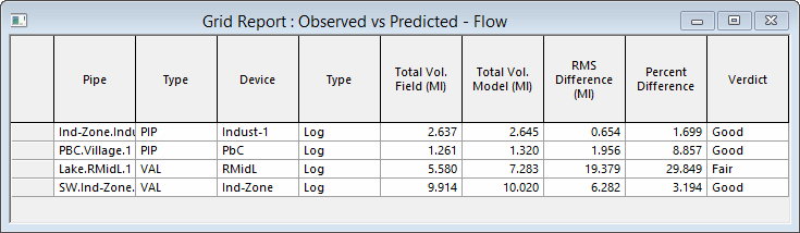

This view lists details of the correspondence between model and field data for objects for which field data is available.
The view is displayed by selecting
Results
Grid reports
Observed vs predicted, then completing the
Grid Report (Observed v Predicted) dialog. The fields displayed in the report will depend on the report type selected (Flow, Pressure, Reservoir, Concentration).
| Item | Description |
| Observed v predicted report fields |
Node / Pipe: Node or Pipe ID. Type: A three letter code for the pipe type. (Applicable to Flow report only.) Device: ID of the Live Data Device. Type: Either LOGGER or TELEMETRY. Total Vol. Field: The total volume from the Live Data measuring device. (Applicable to Flow report only.) Total Vol. Model: The total volume predicted by the model. (Applicable to Flow report only.) Average <data type> Field: Average value from field data measurements. Where data type is:
(Not applicable to Flow report.) Average <data type> Model: Average value predicted by the model. Where data type is:
(Not applicable to Flow report.) RMS Difference: Root Mean Square Error calculated as:
Where: S(t) = simulated (model) data value at timetstep t L(t) = field (observed) data value at timestep t n = number of timesteps during simulation Percent Difference: Percentage Difference between Observed and Predicted values calculated as:
Where: S(t) = simulated (model) data value at timetstep t L(t) = field (observed) data value at timestep t Trend Fit: The trend fit is the percentage of timesteps at which model results and field data have the same trend. In other words, both are increasing, or both are decreasing. (Applicable to Reservoir report only.) Verdict: GOOD, FAIR or POOR based on the limits set on the Calibration Parameters page of the Options dialog. |
