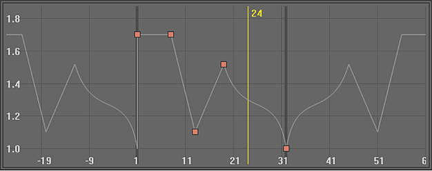

Setting Extrapolation
Extrapolation defines the shape of the animation curve outside the keyframes. You can set up a cycle in which channel values change repeatedly in the same manner over time. You can set the extrapolation before the first keyframe separately from the extrapolation after the last keyframe.
You can specify how keyframes are extrapolated using the following settings.

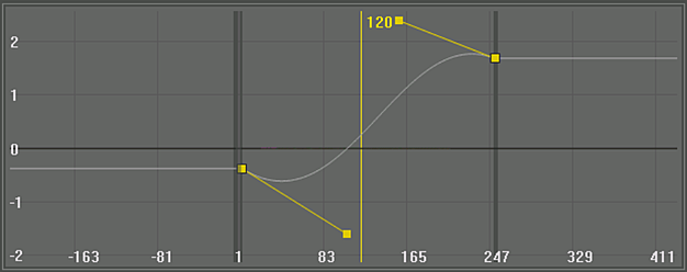

Constant
Creates an extrapolated animation curve that stays at the same value as the first or last keyframe.

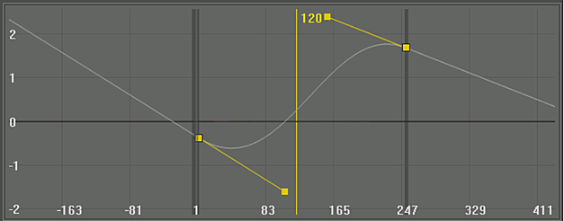

Linear
Creates an animation curve that changes in a linear fashion before the first or after the last keyframe.

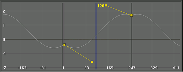

Repeat
Creates a mirror image of the animation curve before the first or after the last keyframe.

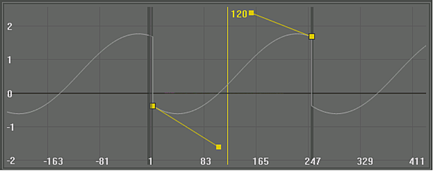

Cycle
Creates a pattern of repeating keyframes before the first of after the last keyframe.
