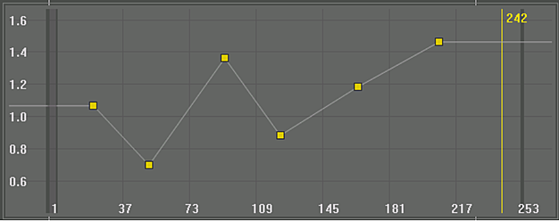

Linear
Joins keyframes with a straight line.

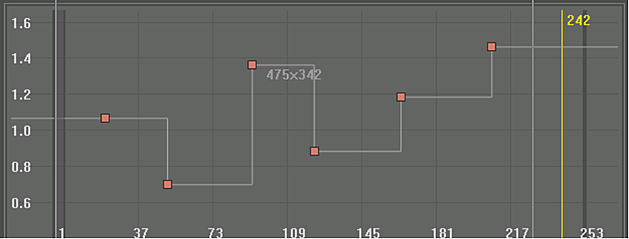

Constant
Produces a square curve. The value of one keyframe is held at a constant value until the next keyframe. This setting can produce abrupt changes between keyframes.

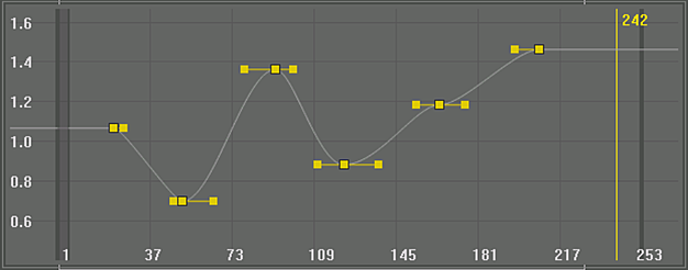

Hermite and Bezier
Produces a smooth curve with a smooth transition between keyframes. Each keyframe on the animation curve has an associated tangent handle. You can change the shape of the animation curve by dragging the tangent handle. Bezier requires fewer keyframes than Hermite to produce a similar curve. This is because there are two tangents at each keyframe: one incoming, one outgoing.

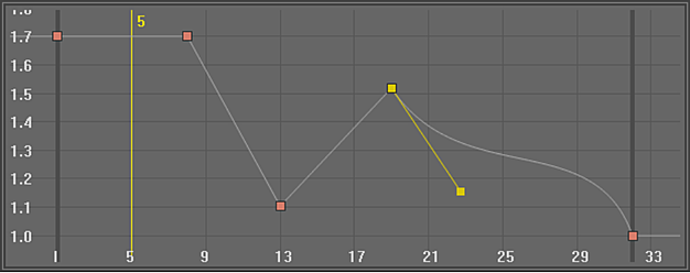

To create an animation curve with mixed interpolation:
  1. Create an animation with at least four keyframes. Do not worry about the interpolation setting at this point.
  2. Display the Channel Editor.
  3. Make sure you are in Move mode and then select the first keyframe. See Editing Keyframes.
  4. Select Constant to set the interpolation for the first keyframe to Constant.
  5. Select the second keyframe.
  6. Select a different interpolation mode, such as Linear.
  7. Select the third keyframe, and then select a different mode, such as Bezier.
    Your animation curve may resemble the following.
