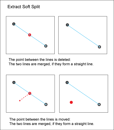

The AutoExtractSoftSplit rule group merges utility lines.
  • AutoExtractSoftSplit_BD
  • AutoExtractSoftSplit_AD
  • AutoExtractSoftSplit_BU
  • AutoExtractSoftSplit_AU
Case 1—Merges lines when the point between them is deleted. In the following case: They share the same attribute. The geometries are such that the two lines could be the result of a soft split.
Case 2—Merges lines when the point between them is moved away. In the following case: They share the same attribute feature. The geometries are such that the two lines could be the result of a soft split. This action disconnects the lines from the moved point.
