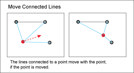

MoveConnectedLines rule group
The MoveConnectedLines rule group moves lines connected to a point when the point is moved, such that the line and the point stay connected.
  • MoveConnectedLines_BU
  • MoveConnectedLines_AU
The rule group applies to Utility point feature classes.
