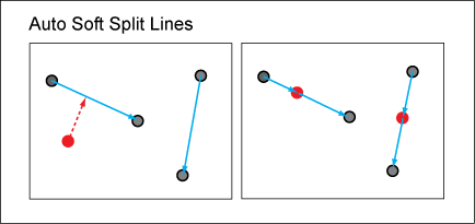

AutoSoftSplitLines rule group
The AutoSoftSplitLines rule group soft-splits a line when a point is moved to the line, or inserted onto the line.
You can select or clear these two cases individually using the before/after update (point is moved) and the before/after insert (point is inserted) check boxes. After a soft split, the two new lines share the same attribute feature.
  • AutoSoftSplitLines_BIU
  • AutoSoftSplitLines_AIU
The rule group applies to Utility point feature classes.
